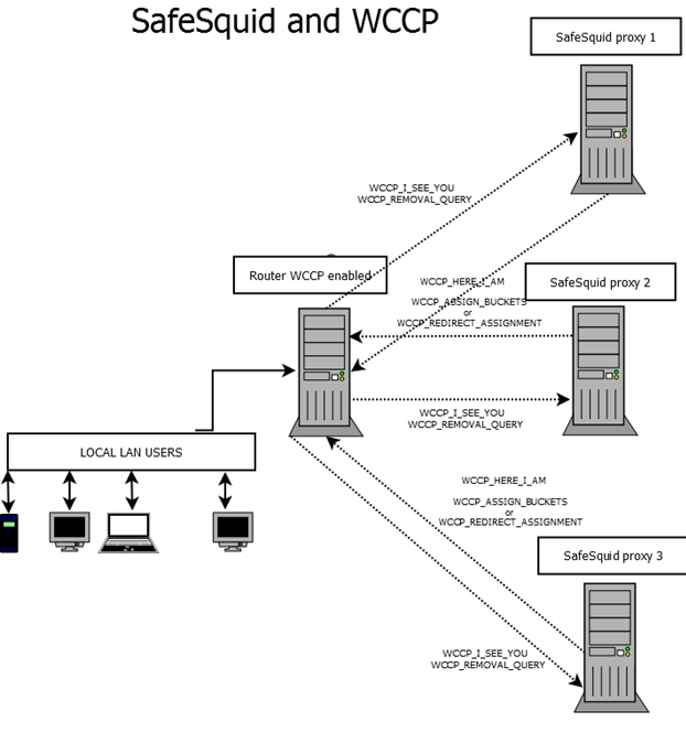

The below picture will tell you whole story.
Safesquid and WCCP  - Describes the communication between WCCP enabled Router and SafeSquid Proxy
WCCP Describes the communication between WCCP enabled Router and SafeSquid Proxy (Web-cache) to implement transparent redirection with scaling and fail-safe benefits.
1.Enable WCCP and transparent redirection support in Routers (Gateway).
2.Configure SafeSquid Proxies (Web-Caches) with WCCP enabled router information to work in coordination to participate in transparent redirection. SafeSquid proxies will send HERE I AM messages to routers and routers acknowledge with I SEE YOUR messages. After then all together will be ready to serve client’s traffic. One of the SafeSquid proxies will become master & implement redirection rules and inform to router using REDIRECT ASSIGNMENT. Routers are ready to forward traffic as told by SafeSquid proxy.
3.Users are configured to use WCCP enabled router as gateway and router denies direct access to the internet and redirects incoming packets(traffic) to the group of SafeSquid proxies which are interacted with router using WCCP Protocol. SafeSquid proxies will serve traffic.
